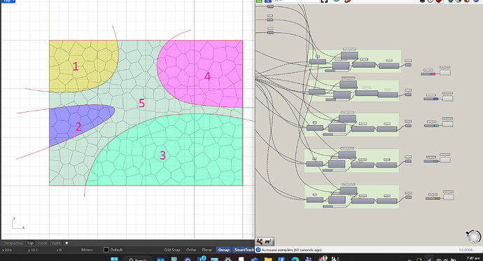

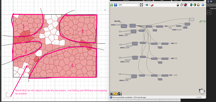

Hello guys,
Ive used collision to detect which cells are grouped based on the curves , But
need a visual clue on how to group a set of cells based on the proximity
Also to extract a sublist and then find which are all were left
Attaching script with internalized curves
star columns attractor.gh (41.5 KB)
Thank you guys, for your help on this.Much appreciated!!
I’m not sure I’m understanding 100%.
Is this close to what you’re after?
star columns attractor.gh (45.2 KB)
Summary:
- find/remove cells colliding with curves
- find cells within all regions

Hello, that’s close
I would like to have all the remaining cells as well if possible near the curve
So many thanks for your help so far
If you don’t mind, would you ellaborate me on how do I achieve from here on
On how to have the cells near the curves as well part of the present grouped cells on the corners
Thank you!!

I would like to have the open curves trimmed with the cells, so to acheieve the curve determining the groups of cells
Like in here , below image
Here’s the updated script
star columns attractor_V1.gh (50.1 KB)
The centre path is a walkway, it should be as a seperate cell group

Ive re worked and managed to create cells trimmed
Now need to pack them as groups to appropriate curves at the corners
Attaching script below
star columns attractor_V2.gh (51.9 KB)

ACHIEVED
