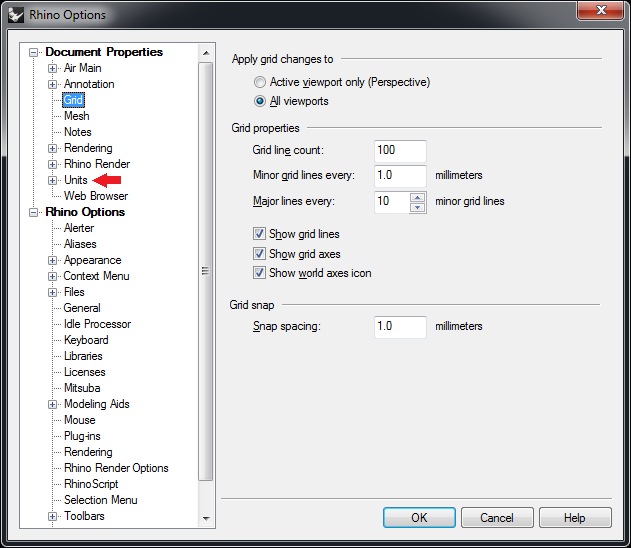

if you run the _DocumentProperties
command, you will see the window below from which you can change the units to inch (under Units) and control the grid spacing and snap size (under Grid).
c.
Thanks!
