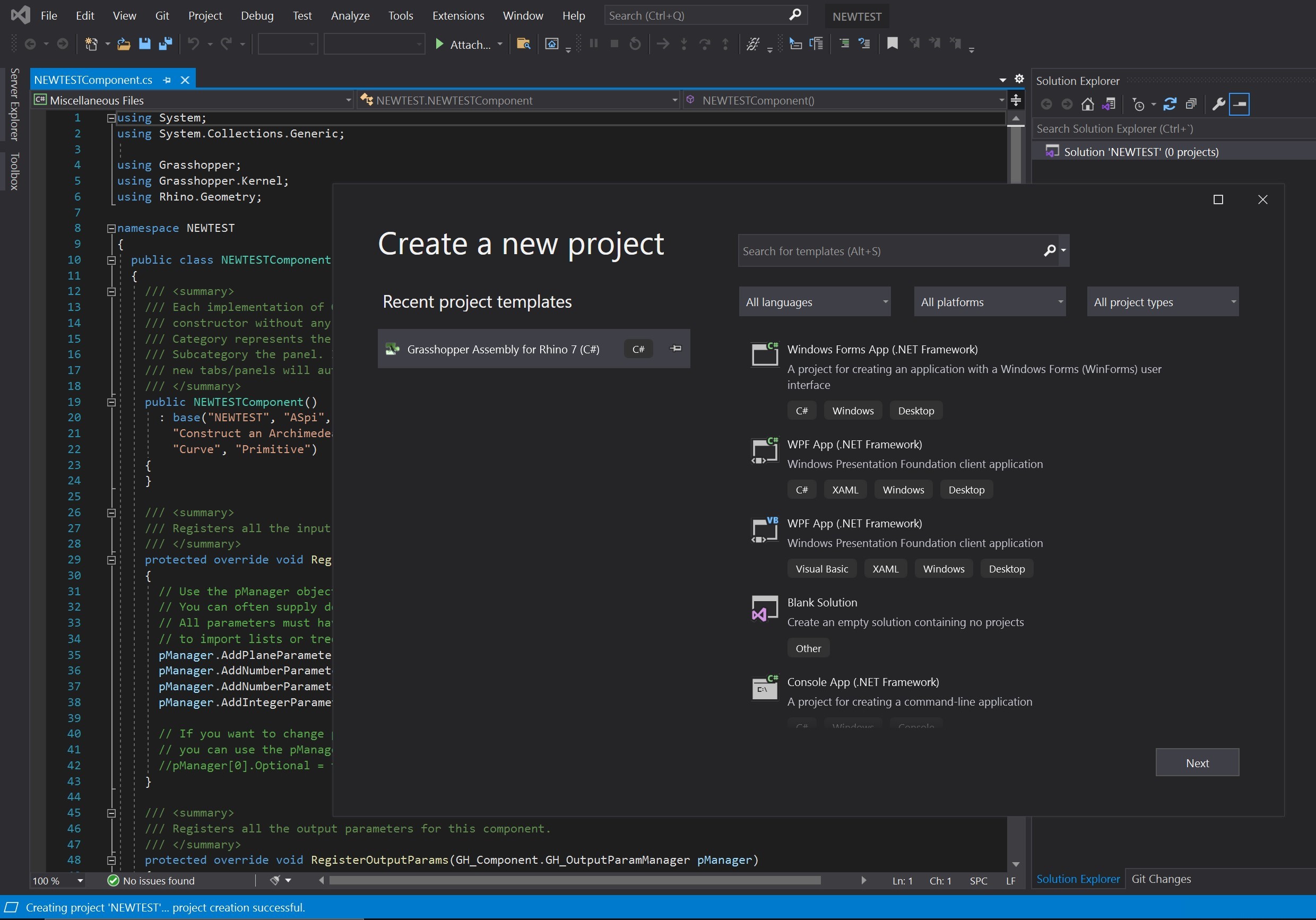

I following GH-guide and also some the public youtube videos to develop my first plugin but when I use the template there are some issues I using VS2019.
I don’t know why? because there are easy steps to follow and aparently these configurations area automatically, I think some linked references are missing. I am a newbie VS user but
1.There is no BUILD in the Menu.
2.Solutions-Configurations and Solutions-Platforms are LOCKED.
3.There is an ATTACH instead of
4.In Solution Explorer appear “0” project…
I don’t believe is a template issue because I reinstall all again but the problem continue or what could have happened?
A bit frustrated because is the first step… Could someone explain to me what happened or is there probably a manual way to fix it? please :pray:t2:

I don’t understand, on your screenshot there is NO PROJECT. There is just one solution.
Please post a screen capture of File → New Project to see what you have !
but this is what I get and no understand why
Ok, so if you click on Grasshopper Assembly then NEXT then accept everything do you have a project created in your solution. Please take a screenshot at each step
I create a GGGG project but still 0 project

Since the project and code files have been created try now right-clicking our solution entry in the solution explorer and choose Add > Existing project... and select the NEWTEST.csproj file. Once you have done that make sure to save all files before closing Visual Studio.
If that doesn’t work perhaps make a screen recording (with say open broadcast software) of how you create a new solution and project and share that recording.
@nathanletwory thank you it works The issue was I missing some “optional tools”

After your suggestion this windows appeared
Then I installed the .NET SDK (out of support) and apparently work but when I debug there is no bin folder. So I found this discussion and installed the .NET Framework 4.8 development tools and finally works.
