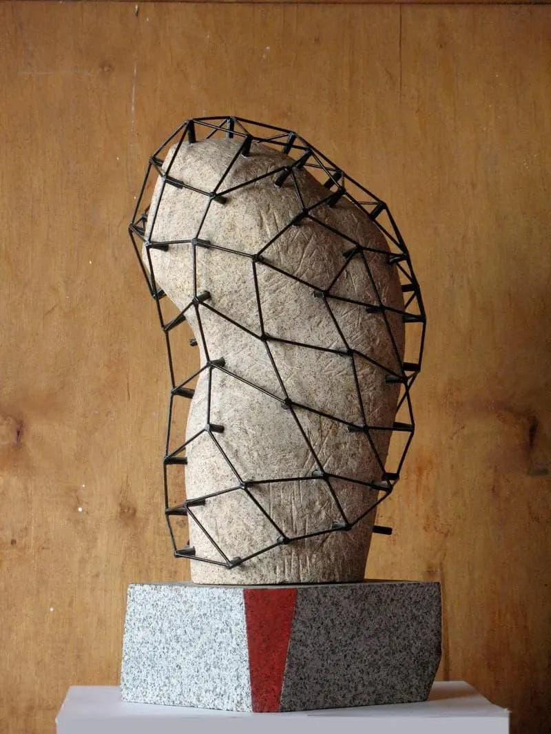

Hello! I have this sculpture that I need to recreate purely using grasshopper, and I already have the boulder and the base, I’m just having trouble on how and where to start for the cage part. These are the only photos of this sculpture that I could find online. Any help is appreciated.

what are you going to do with the result / final data ?
do you need to replicate 1:1 all details - or do you just want a result that feels like the referene in therms of style / aesthetics ?
if aesthetics is what you after i would suggest:
  • start with a rough triangulated mesh
  • add some randomness to the point positions.
  • merge as many neighboured faces (triangles) as possible to become quads
  • merge a random number or a percentage of triangles with neighboured quads to become 5-sided faces (“5-gons”).

you can use the photos and set them in different viewports or use them as picture frames… which would be more manual modelling.
i like that there are unconnected bolts.
:wink:
Could I replace the “mesh” with my boulder brep? Or do I convert my brep into a mesh?
You can do either of those things
