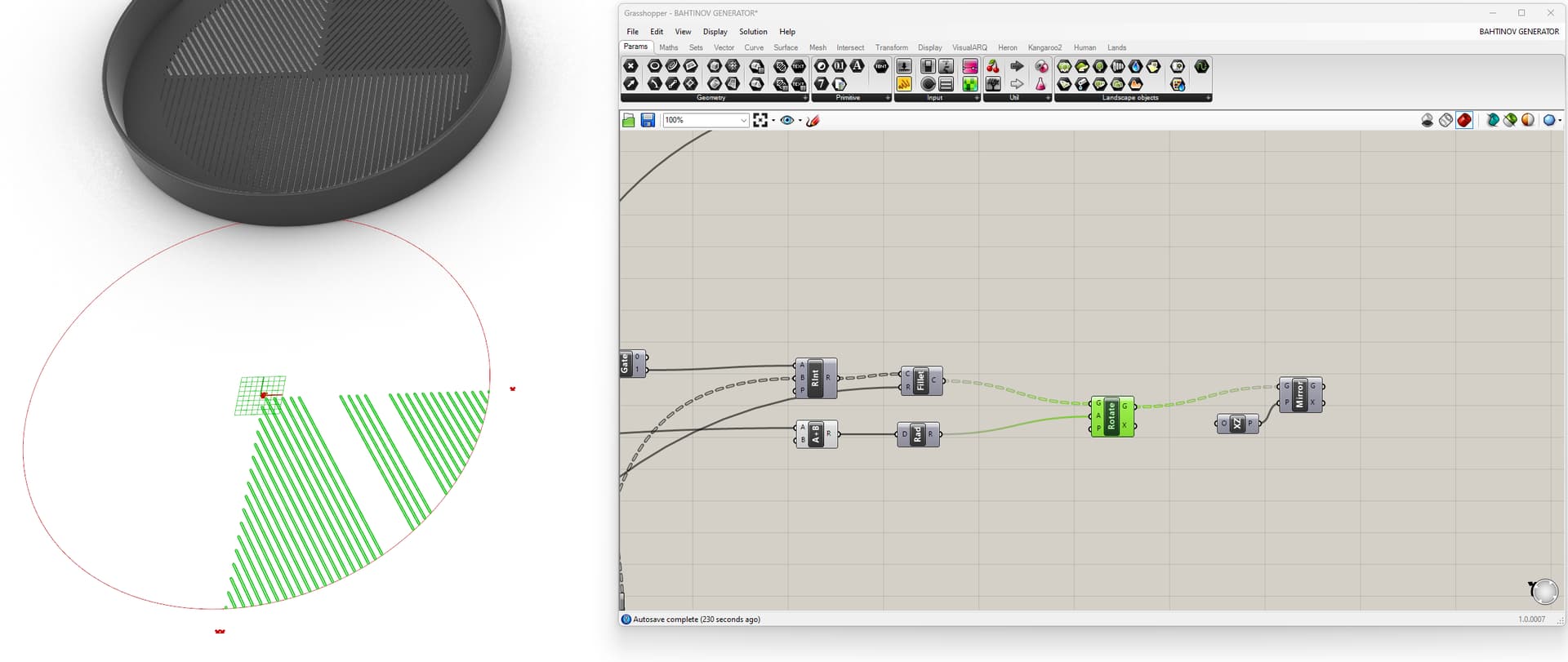

Hi, I am making a Bahtinov filter generator and encounter a strange phenomena where when I rotate objects not all objects are rotated:

And here rotated:
And then when I combine all and mirror I loose even more data…

And if I adjust the radius, hole width or distance, then it changes what objects are not rotated or not mirrored.
I found a thing that solved it and that is subtracting 0.01 from the filleting of the curves. Is that a bug since it fillets the curves, but fails to rotate the filleted curves?
as result of the Fillet you indeed get some invalid Curves, which are not mirrored / rotated because invalid
I also see you are using Combine Data with multiple streams in the same input, where instead you might want to use Merge connecting each stream to a different input (not that the result would change, it’s just for clarity: Combine data is not doing anything to the data in that definition, it’s just used as “data container”)
is something like this the final shape you are after?
