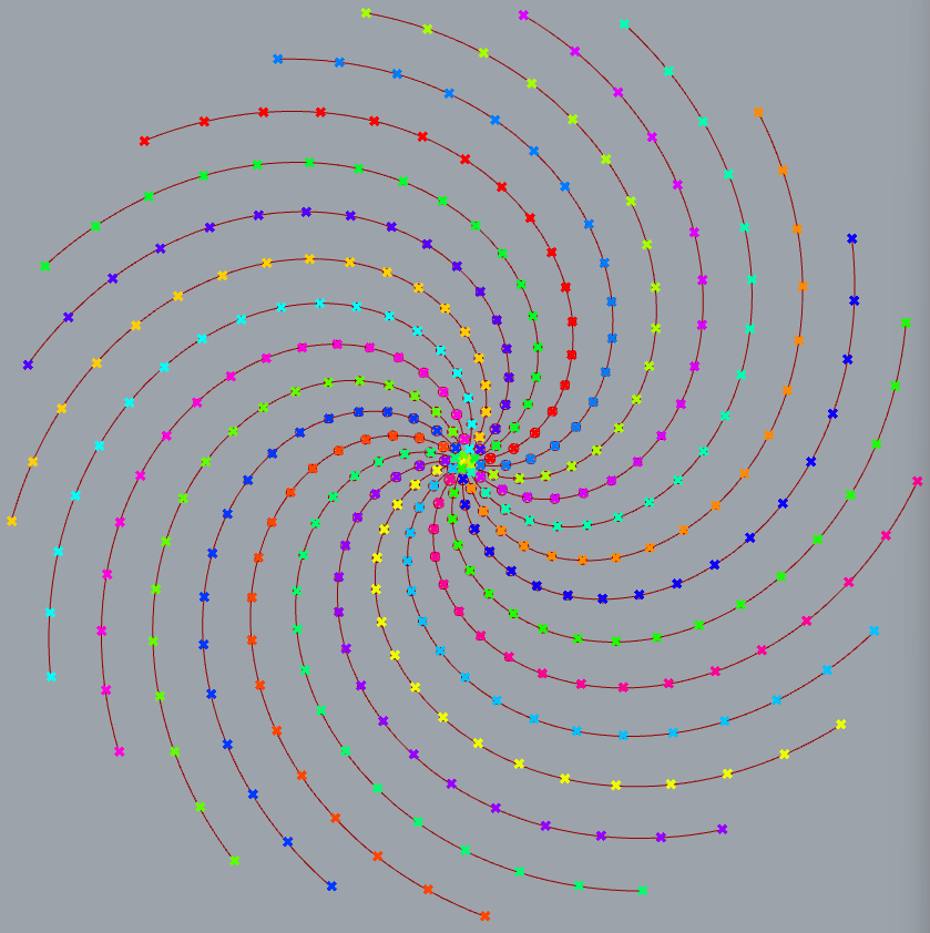

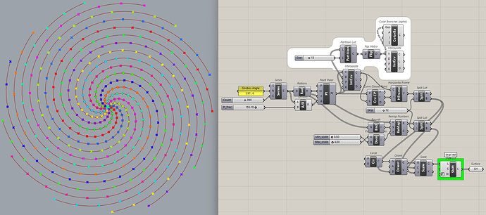

I made a few changes to [the code I referred you to](https://discourse.mcneel.com/t/rotation-problems/164126/12), mostly deletions.
 ![spiral_2024_Jul12a](https://global.discourse-cdn.com/mcneel/uploads/default/original/4X/7/d/7/7d7498aebf6920d98342eac6b75233ac19f4d564.png)
> **3. Attach minimal versions of all the relevant files**
**P.S.** I think it makes more sense to have small circles in the center and big circles “outside”:
 ![spiral_2024_Jul12a2](https://global.discourse-cdn.com/mcneel/uploads/default/original/4X/8/0/f/80f5cd25171c7d23d29c670ee796a9de6af361c0.png)

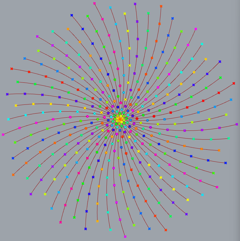

Playing with the code, I can see spirals like these.
Partition size = 13:
 ![spiral_2024_Jul13a](https://global.discourse-cdn.com/mcneel/uploads/default/original/4X/9/c/2/9c22750dbc349068a7d1b199e738c5a5ebcc04a6.png)
Partition size = 21:
 ![spiral_2024_Jul13a2](https://global.discourse-cdn.com/mcneel/uploads/default/original/4X/5/2/c/52ce3d4fa577ab93a5f301a09dc00f9d3b0753d2.png)
Partition size = 34:
 ![spiral_2024_Jul13a3](https://global.discourse-cdn.com/mcneel/uploads/default/original/4X/5/d/0/5d0132a0fba086477e38131fcbbb09a442955656.png)
Partition size = 55:
 ![spiral_2024_Jul13a4](https://global.discourse-cdn.com/mcneel/uploads/default/original/4X/1/3/4/1348b1608602020db6264f2c79175515730fab5a.png)
Why these partition sizes? Off hand, I have no idea. There might be others and this code is by no means the only way to achieve your pattern of circles.
