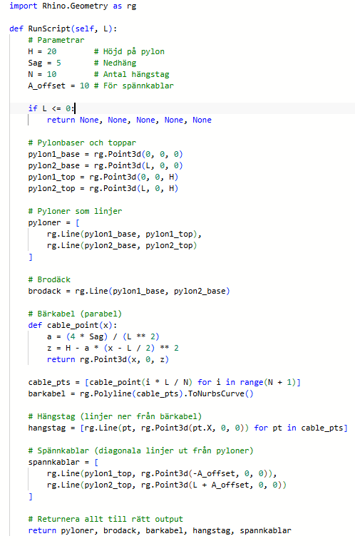

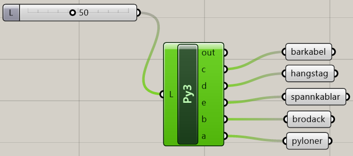

Im trying to model a bridge on rhino via GHpython, no dimensioning involved (ex. no materialdata, no structure mechanics) just a drawn out model of a suspension bridge. the issue is that whatever I do in GH no matter how simple wont show up visually in Rhino, so far I’ve tried to look through these forums, check it with AI, watched countless youtube videos but nothing has helped so far. I’ve also tried changing the python code, zoom extent in Rhino, opening up safe mode, enable preview manually and I havent changed any of the default settings. How do I make it appear in Rhino? btw, some of the texts are in swedish.

you defined a function that´s never called-? (as including a print shows)
the panel does not show an output - so its not a rhino display problem.
bro_jvs01.gh (11.3 KB)
or …you go for:
bro_jvs02.gh (10.6 KB)
