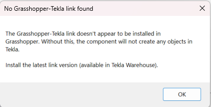

Greetings,
I’m getting this error when opening grasshopper component (version 1.3). I have evaluation license for rhinoceros 8, any idea what could be causing this?
 ![error](https://global.discourse-cdn.com/mcneel/uploads/default/original/4X/6/8/e/68e84af1f921158c21eba30f12298a3914a19356.jpeg)
![tekla](https://global.discourse-cdn.com/mcneel/uploads/default/original/4X/0/0/3/003b917580a93392b61ab64ab7478d64f366dbe8.jpeg)
<div class="post-metadata">
**Author:** ![sebastian.lindholm](https://sea3.discourse-cdn.com/mcneel/user_avatar/discourse.mcneel.com/sebastian.lindholm/32/721567_2.png) [@sebastian.lindholm](https://discourse.mcneel.com/u/sebastian.lindholm)\
**Post date:** [November 13, 2023, 7:39am UTC](https://discourse.mcneel.com/t/grasshopper-component-error/169059/2 "2023-11-13T07:39:50Z")
</div>
Hi Egidijus,
It seems to be because of the fact that Rhino 8 uses .NET core rather than .NET framework. Check this post on how to remedy the situation:
> [@Grasshopper (Rhino 7) Inside Tekla (Version 2021 SP9) error](https://discourse.mcneel.com/t/grasshopper-rhino-7-inside-tekla-version-2021-sp9-error/168708/3):
> Hi, thanks for reporting. The Grasshopper Component will use the newest version of Rhino it can find that’s not WIP, so it will switch to use the newly released final version of Rhino 8 if you’ve got that installed. The problem is that Rhino 8 uses .NET 7 per default rather than the .NET Framework, which doesn’t seem to work with Tekla. To get the Tekla-Grasshopper link to work from within Grasshopper with Rhino 8, the fix as per the article is to use the SetDotNetRuntime command and set it…

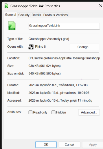

Thanks for quick response.
The error that appeared at first is now gone but I’ve got another one now:
![image](https://global.discourse-cdn.com/mcneel/uploads/default/original/4X/e/a/3/ea31aa3edfe7e7adc714740b409f334b146b01ea.png)
Looks like linking problem but it in grasshopper, I can see it uses the version provided by your reply post.
![image](https://global.discourse-cdn.com/mcneel/uploads/default/original/4X/8/3/8/83807beb65b6aded74bb75e79fd263d895bbca14.png)
The file in components library isn’t locked:
 ![image](https://global.discourse-cdn.com/mcneel/uploads/default/original/4X/d/0/6/d06cdead35e1de17bb2eabbe272b9487bf1cbc7b.png)
Any ideas?

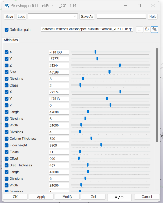

I assume the dialog in Tekla remains unpopulated after closing the warning, but can you still click the pen button to open the script in GH from the dialog?
![image](https://global.discourse-cdn.com/mcneel/uploads/default/original/4X/7/c/2/7c2089b074ad33b45504832ec4d12f67701deb61.png)
Is the Tekla tab visible in GH? What does the definition look like? Something else missing than the Tekla components?

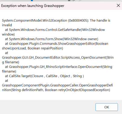

After clicking “OK” on the error, I do see the Attributes and input window:
 ![image](https://global.discourse-cdn.com/mcneel/uploads/default/original/4X/1/6/3/16373b864e0797c9b398ee81a5d88da8aa185525.png)
If I click on the “Open definition…” button, I get this:
![image](https://global.discourse-cdn.com/mcneel/uploads/default/original/4X/2/c/7/2c7569ec75248c2c207b1e1dcfb8aabb43129e11.png)
Yes, tekla tab is visible in grasshopper, I don’t have many other components but the ones I do, seem to be there.
 ![image](https://global.discourse-cdn.com/mcneel/uploads/default/original/4X/1/3/f/13fb2a6ec4da49d17e3771f6a72c4e15f13bfa95.png)

Hi, so the plugin works except for those messages then?
Here’s a small update that should show which grasshopper libraries are currently loaded when it claims that the Tekla link isn’t installed, shows up in the same message box:
[https://drive.google.com/drive/folders/1ASnmQUpP7rkC7vjthVTFF9nGkvJyfOz\_?usp=sharing](https://drive.google.com/drive/folders/1ASnmQUpP7rkC7vjthVTFF9nGkvJyfOz_?usp=sharing)
Check what this says when you have a chance. You probably need to uninstall the previous version with the Extension Manager in Tekla first.
Cheers,
-b
**Author:** ![Egidijus\_Grėbliūnas](https://sea3.discourse-cdn.com/mcneel/user_avatar/discourse.mcneel.com/egidijus_gr%C4%97bli%C5%ABnas/32/507222_2.png) [@Egidijus\_Grėbliūnas](https://discourse.mcneel.com/u/Egidijus_Gr%C4%97bli%C5%ABnas)\
**Post date:** [November 13, 2023, 1:46pm UTC](https://discourse.mcneel.com/t/grasshopper-component-error/169059/7 "2023-11-13T13:46:00Z")
</div>
It worked now.
I think the 1.3 version plugin uninstall was stuck and didn’t uninstall it properly since I had to kill everything associated with Tekla in task manager.
I did start getting the crashes with the GhPython.ga, after removing it, no more crashes or anything.
Thank you very much!
