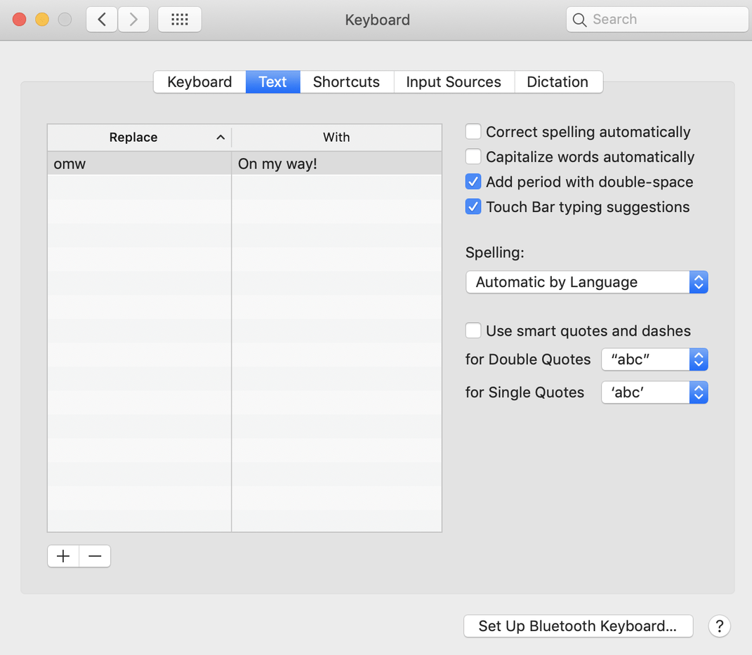

No worries – for anyone else encountering this problem, I eventually figured out that this is a Mac OS issue rather than something specific to Rhino/GH. Under System Preferences > Keyboard > Text, you can just uncheck the “Use smart quotes and dashes”
