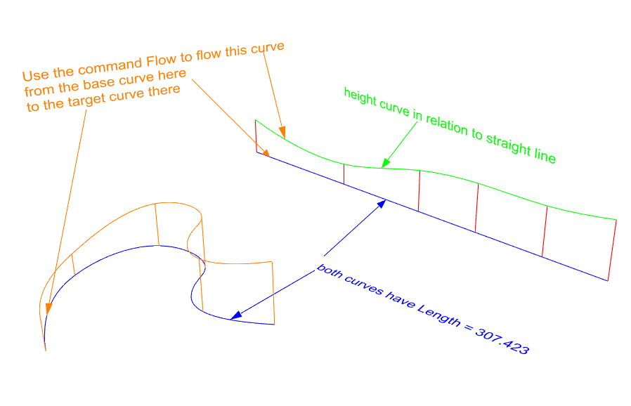

I realise my English is a bit rusty so here is an image to clarify what I’m asking for:

Hi Rave,
I would suggest and use the command Flow for that.
You basically create a straight line the same length as the curve.
On top of that you create the elevated curve as you want.
Next use the flow command to flow the curve from the straight line over the curves one.
HTH
