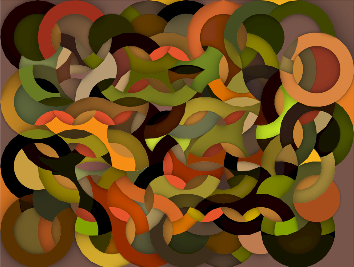

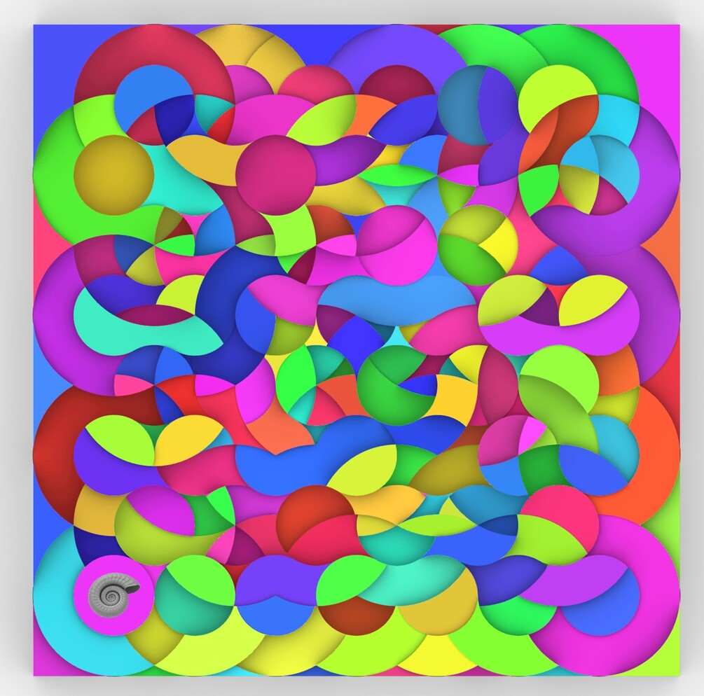

Some new tests
Some new tessellations found answering this question
Some strange creatures emerging
Adding some curve attractor
I like a lot Rhino Rendered Mode, with some extrusion it gives some nice shades
