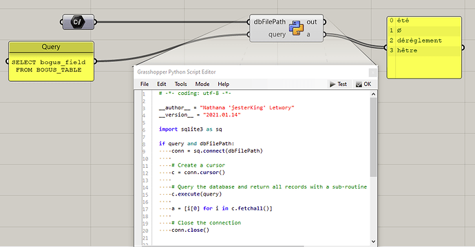

Something like this (but then improved and better) would make you feel a bit happier?
accents.gh (4.7 KB)
For instance the component could parse the Query string to see how many fields are asked. Or even just directly the results to see how many there are. Figure out from the database schema what the names for these are and add those outputs magically for you.
Of course, multitable databases are going to be more tricky, but still is possible to do.
jSwan by @andheum is a nice example of automatic output population based on what the input (JSON) is.
So it is definitely possible to do something like jSwan, but then for SQLite (or other databases even, no doubt).
I suspect it would be a hit !

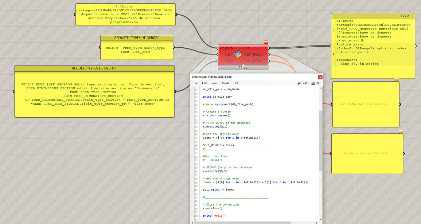

So now, I need to concatenate two indices of the tuples ; no luck so far :
I guess you meant
SQL2_RESULT = [i[0] + i[1] for i in c.fetchall()]
Exactly !
Thanks

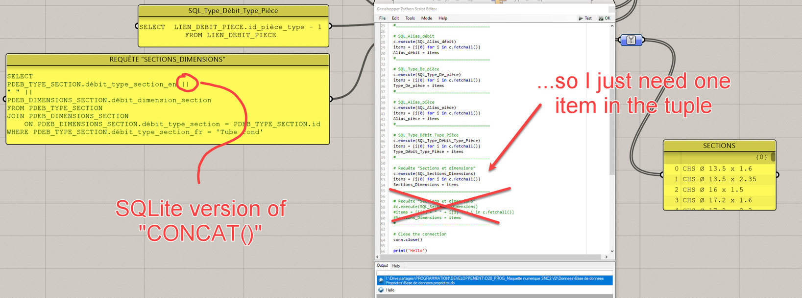

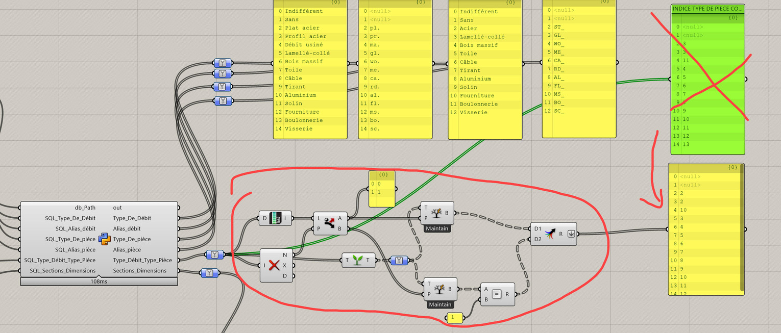

Any idea why I can’t intergrate a simple operation on the items I retrieve with my query ?
I just want to substract “1” because the item numbers in the database start at “1” whereas GH trees start at “0”.
Also, I do have some nulls, and I don’t want them to become an integer when I substract 1 .
I managed to do it with GH components, but I admit it’s not very elegant :

Even better : I can concatenate my data with SQLite instead of Python …
Note that the operator is “||” for SQLite instead of the usual “CONCAT” :
