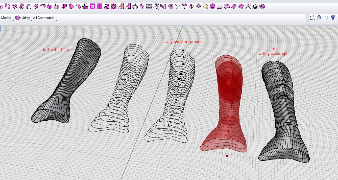

I have tried almost every way to fix the loft I need within fixes all the seams by provided solutions others offered for the same problem! I have checked my start points of the curves and they are aligned. Loft is working beautifully with Rhino itself, but when I try to make the loft with grasshopper it doesn’t work.
Will appreciate it if someone help me with this problem.hand splint loft.gh (51.0 KB)
loft problem.3dm (1.7 MB)
Where is the problem ?
You can use this
Thanks a million, I dunno what was the problem but its working with you way. thanks again
