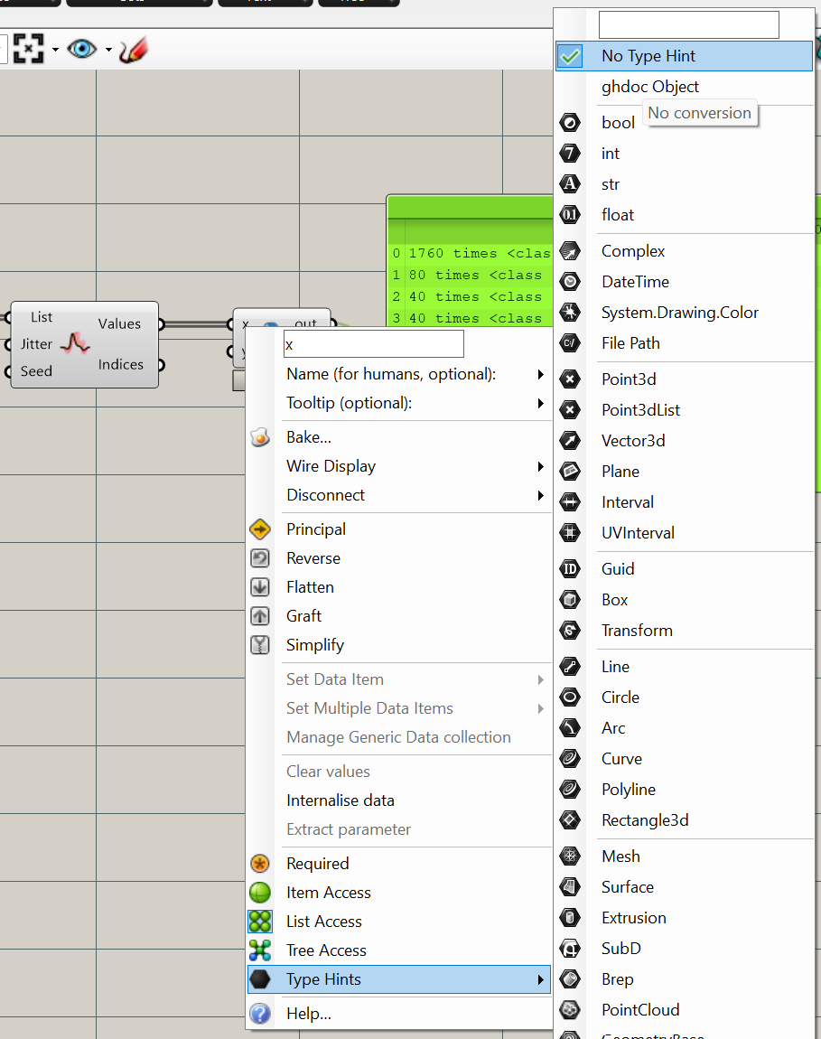

make sure to set the typehint to “no type hint” :upside_down_face:
