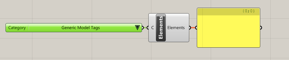

I had issues filtering generic model tags from revit doc in Rhino Inside. I could filter column and other elements by category but somehow it fails for tags. Would be great if there can be a workaround this.

Right now this component lists all elements of a category that are visible in all views.
But I fixed this.
If you update your source code copy you should have the changes.
yes, it does! I checked with the updated version. Thank you so much!
