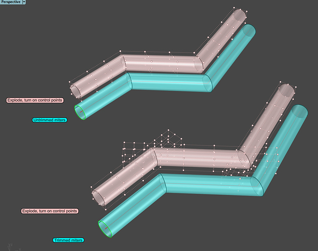

Sweep1 Untrimmed Miters option should be renamed Trimmed Miters option.
Actually not, the “Unrimmed miters” option makes untrimmed surfaces at the miter joints, otherwise they are trimmed surfaces. Explode the object and check the control points of the resulting surfaces to see.
–Mitch
Please do it - you will find out that you are wrong.
Here ya go…
Your picture proves that you are wrong.
No, “Untrimmed” means there’s no trimmed surface.
Nope. The upper set are all UNTRIMMED surfaces. The lower set are all TRIMMED surfaces.
https://wiki.mcneel.com/rhino/nurbssurfaces
“We refer to a surface with outer loop that is the same as that of its underlying NURBS surface and that has no holes as an untrimmed surface.”
That is the case with the upper illustration.
–Mitch
Precisely! Untrimmed means that the control points have not been trimmed. They are still extending far beyond the joint.
No, it does not… Untrimmed means there are no trims on the surface. Control points do not get trimmed. If the control point grid extends beyond the edges of a face, then the face has trim curves on those edges.
