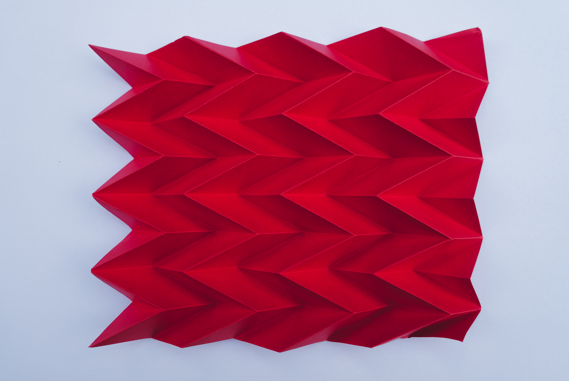

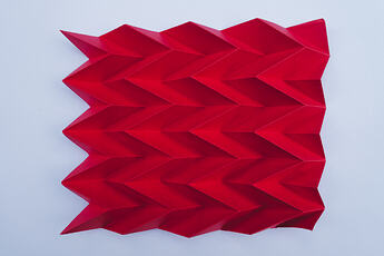

Fold one side of a miuraori fold
I’ve been trying to model a Miuraori fold on grasshopper, and although I have gotten a pattern with uniform folding done using the add-on Crane, I have been unsuccessful in creating a pattern in which only on side of the pattern is folding. modelling it on Rhino yielded bad results and I am new to grasshopper. Does anyone have any method of achieving this?
Uniform fold
non-uniform fold
miura ori.gh (52.5 KB)
