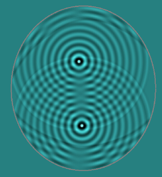

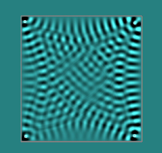

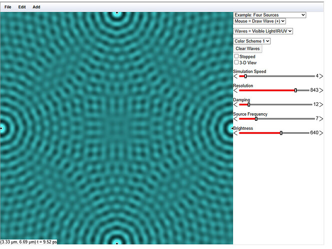

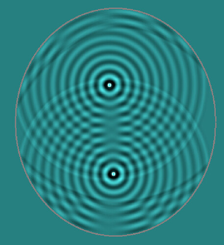

What I’m after is to simulate the wave interfercen patterns sbased on diffrent shape containers.
Currently we are able to produce single source effects but not with itnerference patterns but just the ray trace of the sound particels..
Our primary intention is to generate diffrent shapes and obseve interference patterns in side of them
Currently, the webapp i shared is only doing a few forms like rectangle or ellipse- which is pretty cool but we want to take it further depths and test with other geometries with multiple sources.
Also we want to adjust the frequencies and simulate their behaviors
Hope that explains bit more further
Thank you for the support once again! :folded_hands:
In your model you are literally shooting particles, then you are making the particle “alive” by simulating its own reflections and path. But that would be only the initial positive wave without any negative wave.
(Where is the frequency? Amplitude? … is that really a wave?)
In the webapp instead , very likely there are no particles at all, but the computation is simulating the medium. Each and every pixel (2D) have a value at any given time, the amplitude, and its value is spread to neighbour pixels at each iteration (with laplacian operator or mask).
Speed of spreading is the medium wave speed, and frequency is simply achieved by forcing source pixel to a fixed value over time.
This is just a guess of mine. I may be wrong.
If my guess is right, I would try to make a 3D array of voxels to enclose your volume, and make them follow the same logic…
Calculating the caustics should be just evaluating the voxel values near the surfaces you are interested to…
Excalty! First videos are only single ray bounce and no interference at all..
Thats what we’d like to create like the other images.
