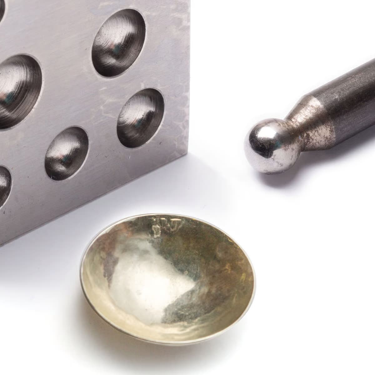

I’m trying to replicate effects from a dapping block:
