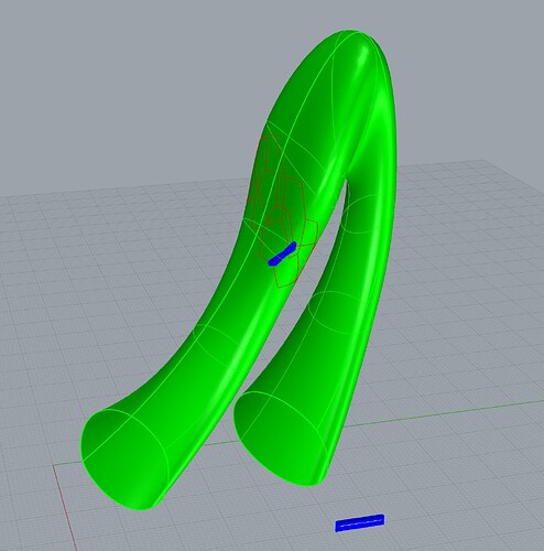

using “flow along curve”, I placed a profile (box) on a surface.
On the left, the profile (blue) follows the projected curve.
On the right, the profile (red) follows the projected curve and is perpendicular to the surface.
The surface solution is easy to find in Rhino´s “flow along curve”.
In grasshopper, it is not that easy.
How would you guys do it in grasshopper? Because I have more than just one curve on an organic surface.
Thanks.

to make my question very clear.
How to place an object (blue) on a curve (red) and perpendicular to the surface (green) on which the curve is projected on?
In Rhino this works with “flow along curve”.
How would it work for many than one curve in Grasshopper?
Thanks in advance.

I don’t know how you transferred the lines to the surface.
You could use the same method to transfer the brep.
Try this definition but I don’t know if it meets your needs.
hexagon.gh (874.8 KB)
I think a different approach might be to use the part of definition you didn’t post, the one that generates those curves in first place, and then maybe use those to build offsets and create the final pattern not from small units but as a whole

I can’t find any option for the equivalent of Rhino’s Flow along curveTargetsurface in Rhinocommon
https://developer.rhino3d.com/api/rhinocommon/rhino.geometry.morphs.flowspacemorph/flowspacemorph?version=8.x#(curve,curve,bool,bool,bool)
it would for sure be useful to have
Sporph v0.gh (28.4 KB)
