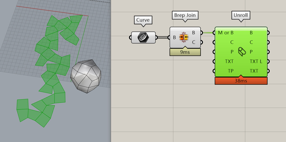

Hard to help without file.
Here is a Grasshopper Definition with OpenNest2 Unroller from particulary non-planar Polylines.
Polyline Unroll.gh (8.1 KB)
