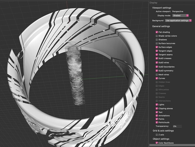

Flat Shading on mac seems to be again broken
 ![image](https://global.discourse-cdn.com/mcneel/uploads/default/original/4X/1/7/3/173fa876d879a2661bb78fe25ae786c3d0d4bdf3.jpeg)
this one is a large mesh… but it display fine in smooth shading.
 ![image](https://global.discourse-cdn.com/mcneel/uploads/default/original/4X/a/d/1/ad17295fcc63b00f99ab77fdff646b1fdf92e883.png)
Rhino 8 [8.11.24247.13002]
[System\_Info\_08-09-24.txt](https://discourse.mcneel.com/uploads/short-url/uwdawW10e3rAjjhIG4xTNdQCPJF.txt) (4.8 KB)
thanks a lot
Akash

For simple low poly mesh, Flat shading works fine…
 ![image](https://global.discourse-cdn.com/mcneel/uploads/default/original/4X/a/e/0/ae05477a52b5e5c978156bacf6a57c2d7bf2cf0d.png)
But this need to work for hi poly too… IMHO mesh objects should display in Rhino in flat shade by default, regardless of the option in the display panel ! after all, smooth shade is there so Nurbs objects could use a low setting for their render mesh…

Flat shade does work in shaded mode… But not in render/Raytrace/Bella modes!
So Rhino can not be used for rendering. here’s what i get trying to render a simple diamond in mesh form. [and yes, converting the mesh gemstones to Nurbs, is easy… but not the rest of the hi poly mesh]
 ![image](https://global.discourse-cdn.com/mcneel/uploads/default/original/4X/9/2/9/92905db251cfc7de2826ab544762df6e97397a9e.jpeg)

Use `Unweld` at 0 to make meshes “always” flat shade.

Thanks a lot @Helvetosaur … I don’t understand how…? but this certainly works!
It does take a few minutes to unweld a large poly count mesh.
- i now remeber you have suggested it in the past… i see have added the button for UnWeld to my UI back then [and forgot what it was for]
Would love to know what unweld angle is?.. How come an object remains closed when it has been unwelded? and does unwelding [the lack of] has something to do with Rhino not displaying the mesh as it is on import ?[which is what i assume Rhino does by default] Was thinking i could add unweld 0 to the OBJ import Macro… upon checking i see the unweld option is only for export.
To the Devs, may I ask, Why don’t you make it so Mesh is flat [shown as it really is] by default, with the Smoothing modifier applied by users when needed ?
