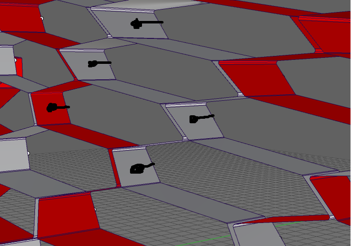

I have a collection of points where objects intersects, I want to move the points in the middle of objects to perforate, how can I get the correct distances to move the poits, someone could help me, thanks.
distances.gh (366.8 KB)
Hi.
Since the points are rhino inputs and are not achieved in your grasshopper file, it may be more complicated to have intended point clusters. With this algorithm, “closest point” component may help. However, if you elaborate on what you want to have (even with some sketches) we can give it a try.
hello , I have the points where the objects intersect the idea is perforate the objects in the middle, I want move those points just i in the middle but the distance is variable so I have no idea how to evaluate it to put the pin, thanks
The point component of your definition consists of 66 points that are positioned in the middle of some front edges, and you want to find the distance of this point from the centers of all surfaces. Is that correct?

This is what I need, I was able find the way, But I would like to know how to find it with another methods.

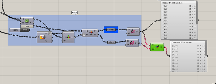

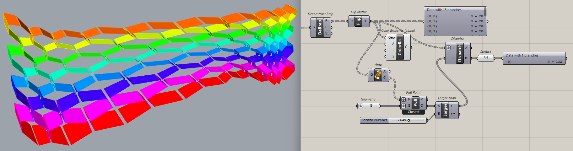

could you help me to get the same order in the tree after dispatching elements?. if in the branch 0 was dispatched 12 elements of 15 reordering branches the branch 0 be with 3 elements and successively
Order tree branch.gh (157.2 KB)

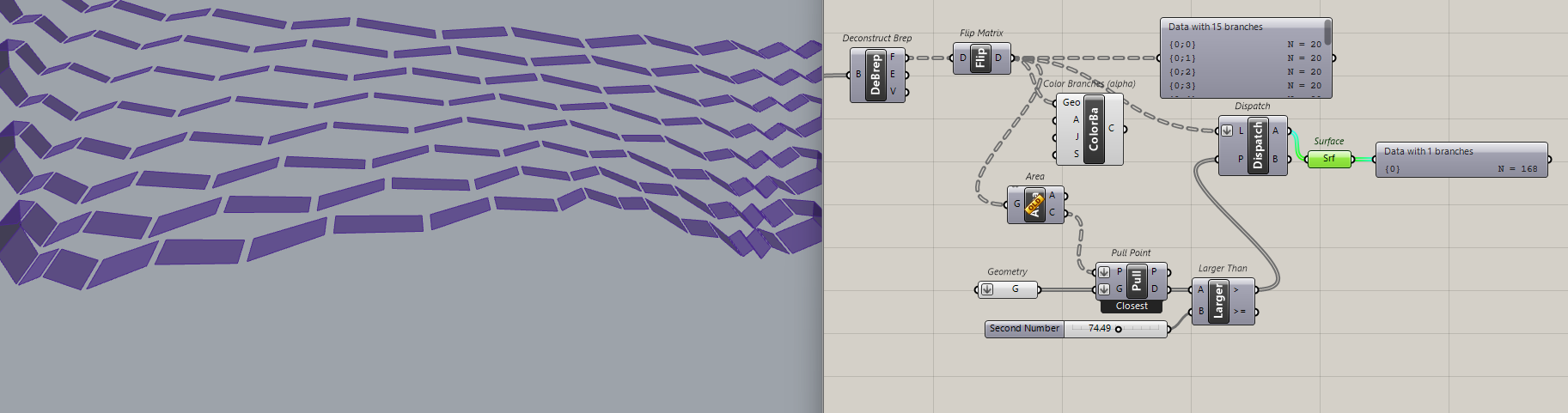

Before Flip Matrix colors are in proper sequence:
After Flip Matrix they are not:
You had 66 points internalized in the ‘G’ input of Pull Point ( :-1:) and 300 points in the ‘P’ input, all flattened :interrobang: So 300 values emerge from the ‘D’ output, but what do they mean?
The ‘B’ output of Dispatch has a flat list of 300 surfaces
 How are they to be sorted? And partitioned?
What about the ‘A’ output of Dispatch :question:

what I was trying to achieve was: after dispatching the surfaces what I needed, retrieve the data structure in the 15 branches.
{0;0} N=20 to {0;0} N=3
{0;1} N=20 to {0;0} N=7
But I hve no idea how to sort it

think itÂŽs enough to just not destroy the datastructure? dont flatten-?
Order tree branch_jvs.gh (157.2 KB)
that helps keeping the list adress
if you need to keep the index in the list too go for sifting instead of dispach to get null items as place holders or graft the tree to get empty lists.

Extra, using split tree (instead of dispatch) if you need it to put it back together correctly:
distances_c.gh (160.6 KB)
