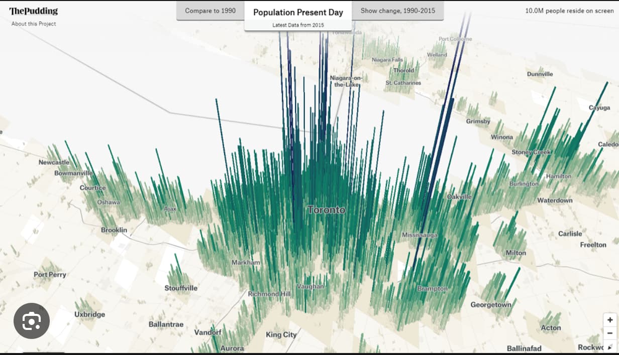

So My second issue is that i would like to extrude each cell that is within the defined boundary (the circle). So i constructed a mesh with the points but am unable to extrude the mesh. so where am i going wrong here?
I would like something that looks similar to this for my end result just with some other variables i would like control over. Obviously I’m not that far down the line of this script yet. So if I’m going about this all wrong, then please feel free to push me in the right direction.
