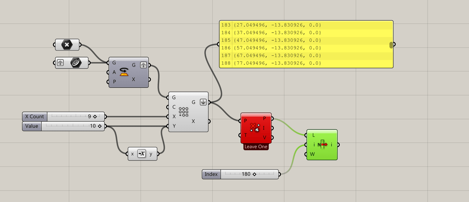

as you see in the panel there is 200 points and many polyline curves.
now I want to select only points to apply another command.

While there is a way to extract the points in your definition, I think it’s simpler just to extract them from the curves themselves.

anyway, here is a quick solution: (it’s a trick. the point component is supposed to look red as it tries to interpret points, but half of the list are not valid points, since they are curves)

when i use cull duplicate command i can select points as i want.
but i do not know why we receive error?

your new way is great and please tell me how can we remove red point error?
we don’t. It’s supposed to be red. (it’s an unconventional but fast way)
it is just telling you one of your items is not a point, and skips it. It won’t effect anything.
