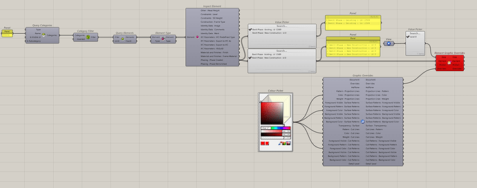

I tried to filter the door that was made in the new construction phase, I have successfully filtered it, but I failed to change the graphic overrides in certain views. do you guys have a solution?
Thanks!

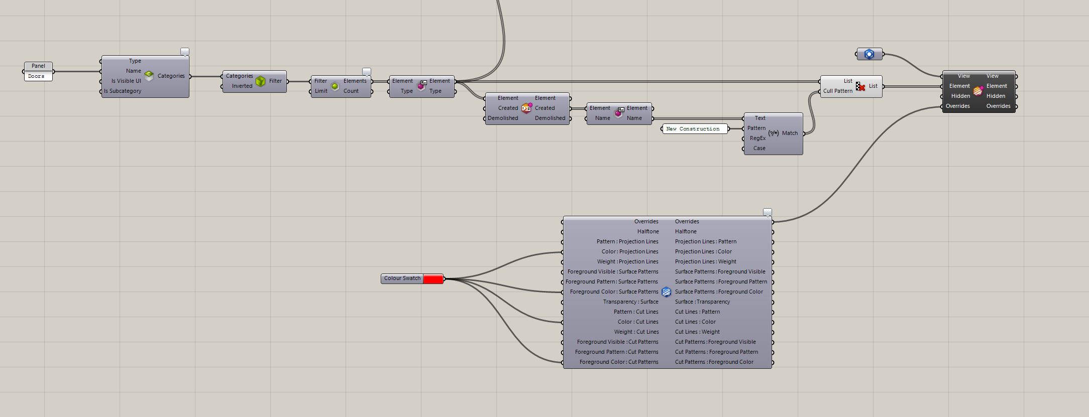

I think it is because you connected the Phasing parameter to element in Element Graphic Overrides. And also connect the View component to the Element Graphic Overrides instead of the Value Picker.
At least, that is how it is working for me.
Filtering doors.gh (12.0 KB)
its work for me!!
thanks for the help
