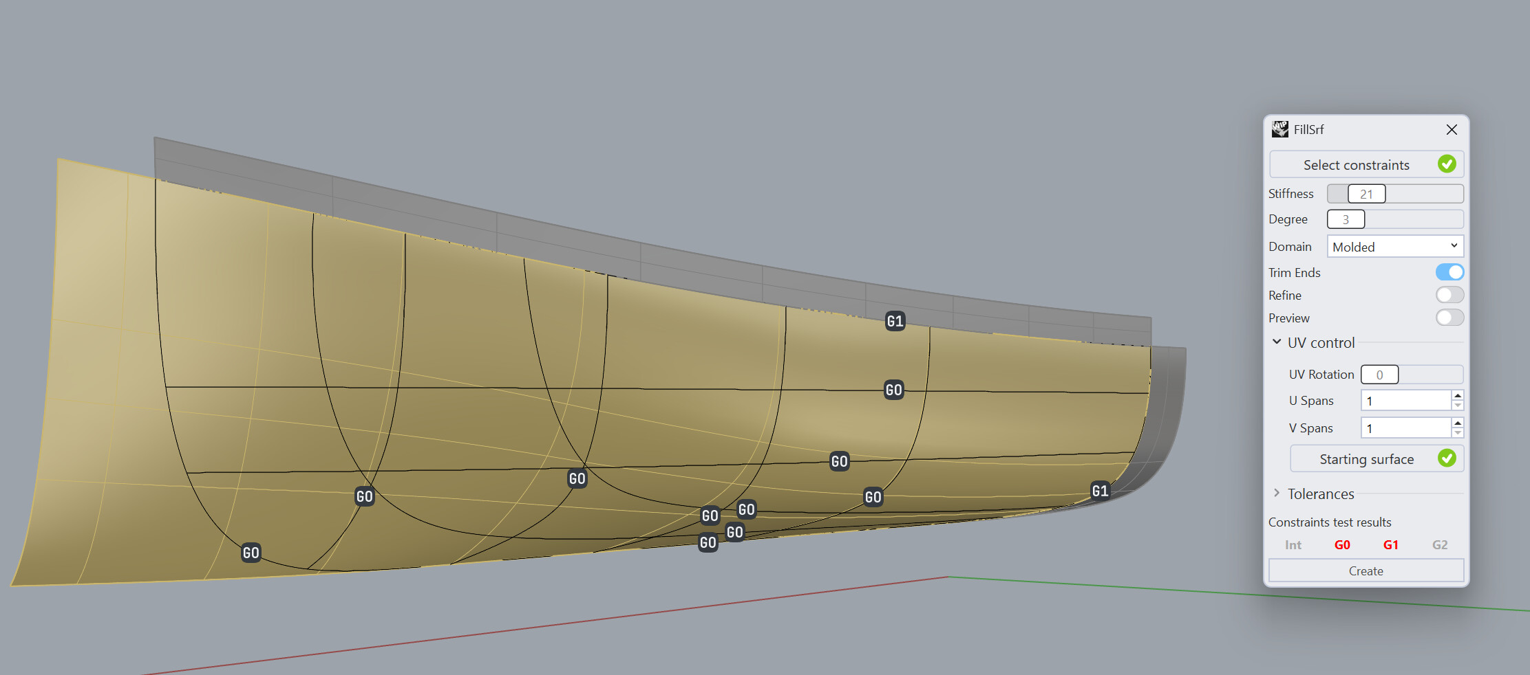

FillSrf: preserve edges of input surface
Starting surface needs at a minimum a PreserveEdges options like Patch has:
Preserve edges
Clamps the edges of the starting surface in place. This is useful if you are using a curve or points for deforming an existing surface, and you do not want the edges of the starting surface to move.
(Added) This option in Patch preserves the untrimmed edges of the starting surface.
The ability to set the level of preservation individually for each untrimmed edge including “not preserved/free” would be excellent.

FillSrf
FillSrf with input curves, tangent constraint surfaces and starting surface
FillSrf result using starting surface.
I turned off Refine as I want to maintain the knot arrangement of the start surface.
FillSrf result - trimmed and shrunk

@Gijs Thanks for the reply. Perhaps the length of my post above has led to my original request being forgotten. It was not about a comparison of the smoothness of the results of FillSrf compared to Patch.
I requested that when a starting surface is used in FillSrf there be an option for the result to preserve the untrimmed edges of the starting surface, as is available in Patch. That allows the user to control the locations of untrimmed edges of the result through use of a starting surface.
In my example above the results of Patch using a starting surface with PreserveEdges option have untrimmed edges except for the curved stem. This is enable by the PreserveEdges option. In contrast the results of FillSrf are a larger surface with all edges trimmed. which are not desired.
An example of what I am after was requested, and my post above was in response to that request. But perhaps I provided too much information.

The internal curves are not completely consisistent, which is typical of vessel lines which have not been extensively reconciled. My need is a “best fit of” the starting surface to the inputs with the edges of the starting surface preserved.That is one of the reasons I use a starting surface to control the number of spans and knot distribution. It is also the reason I turned refine off in FillSrf.
