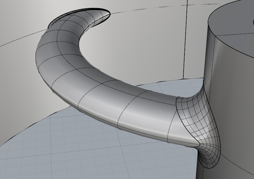

I’m trying to get a fillet on the four spokes where they touch the rim (rolling ball- value = 2) but it won’t give me anything clean. Tried moving the seam, different values and settings other than rolling ball. I can’t see why this should fail. Windows 10 64bit, Rhino 5 and latest update. This isn’t vital, it’s just annoying.
Hi Tone - the ‘back’ edge does not have enough room for a fillet at 2 without its crossing itself. Try setting aradius of 2 at the more open end and .7 at the more crowded end.
Also, I think I like the result from 'DistanceBetweenRails better than RollingBall in this case, still at 2 and .7 - in fact you can boost the smaller radius a bit without its crossing up.

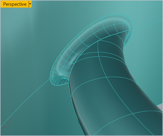

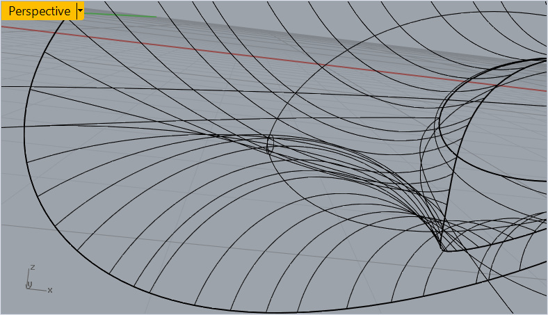

Hi Tone - if you make a FilletSrf at 2 and look at it in wireframe, you can see from the isocurves there what happens - the turn is to tight that the arcs cross one another there.

If geometry goes wrong and they look like a catastrophe, actually, it sort of does :
Had a quick look at Fusion 360 to see what it returned for that fillet at 2mm (and some others)
