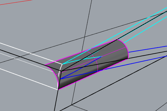

Yep, no way to jump across that middle face in the current way of things - you need hand building, so to speak, with FilletSrf to get that missing fillet:
and then a tiny slice of a sphere to fill in:
Then trimming…

Hello- I underastand this is a pain but there will be situations like this for the forseeable future -
the problem is here:
the missing link is the fillet between these two surfaces:
if you FilletSrf for that, you have most of what you need:
You can trim the fillet surfaces with isocurves at the intersections of the edges:
Which leaves you with the tiny slice to fill. This slice is a sphere.
which can be trimmed with the edges of the fillets:
Or you can, in this case, use the intersection of each long fillet with the short fillet. That is good enough to close the polysurface without the faff of the sphere.
