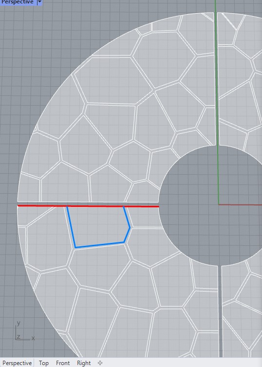

Hey guys, please help me(( I want to shutter this open polyline
in the places where it intersects with my projecred on the surface voronoi structure, and get rid of excess
now it looks like this:
and i want it to look like this:
script itself:
derevoluk4.gh (15.9 KB)
Try Region Intersection.
derevoluk4_re.gh (16.3 KB)
