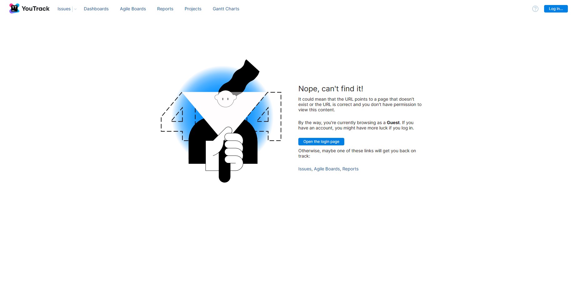

Thanks @AndyPayne ! Much appreciated, and I tried the link but I think it’s private as it’s giving me a 404 error
That should be open now.
Confirmed, thank you @wim
Is this still a valid youtrack? It is giving me a 404 error again.
Thanks @wim !

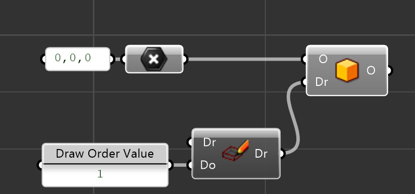

Thanks @AndyPayne , real quick while I have you.
For this wish, rather than having a Draw Order input, ideally the component would “just” read the Draw Order value of the Model Annotation object.
So similar to how you can set annotation overrides now and those show up in the Custom Preview, the Draw Order value set on the Model Object would do the same.
Thanks!
Can you set the draw order for annotation objects already? I was looking for this the other day but due to enormous hurry I did not succeed.
Hi @TuomasLehtonen, In Rhino 8, yes you can with the “Drafting Attributes” component plugged into the Drafting Attributes input of a Model Object component.
