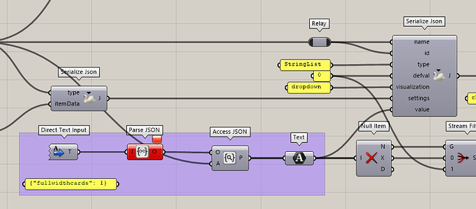

This is a logic common to all the “dynamic parameters” in ShapeDiver. It is not fully documented yet, because this feature is still in beta. You can see the needed logic in this part of the definition I posted above:
You need to add a Direct Text Input component called “AppBuilder” to your definition. When you include dynamic parameters in a definition, this component will return a JSON object containing the list of dynamic parameters that were updated in the App, along with their values.
In the definition, I added a text panel with an example under the component:
{"fullwidthcards": 1}
You can then use JSON components to parse and extract the value, and send it back to the dynamic parameter definition, thus closing the loop.
We will make the handling of such dynamic parameters easier in the future (i.e bypassing the need to understand and parse JSON structures). For now, if you need more help with your definition, feel free to ask more questions or post it so I can help fix it.

If you have several parameters, their values are all sent from a single “AppBuilder” text input, in a single json object. You can check the “Dynamic Sliders Tutorial” on this page to see how to handle multiple dynamic parameters.
If you still have trouble implementing your App, please post a minimal Grasshopper definition showing the issue you are facing.
