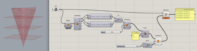

Thanks so much Kevin. The final part-the conical spiral would a script that divides horizontally do?
split_cone_spiral.gh (14.8 KB)
-Kevin
