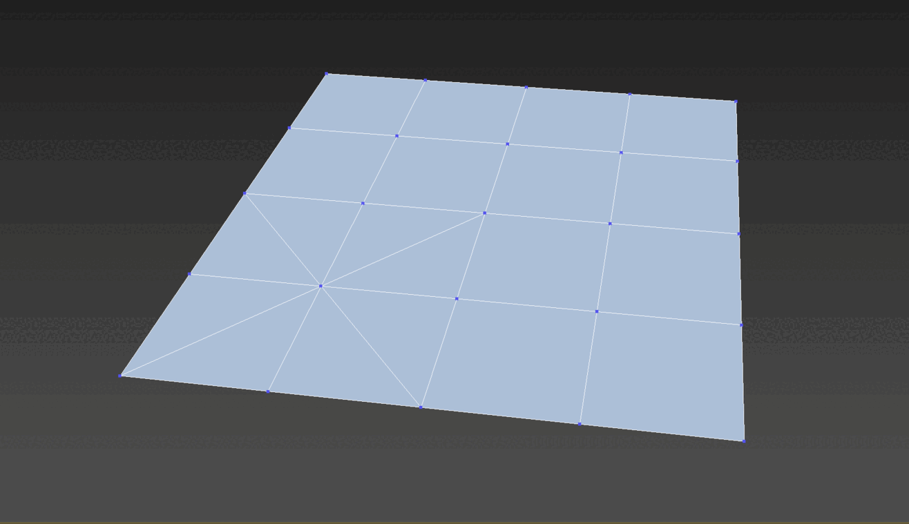

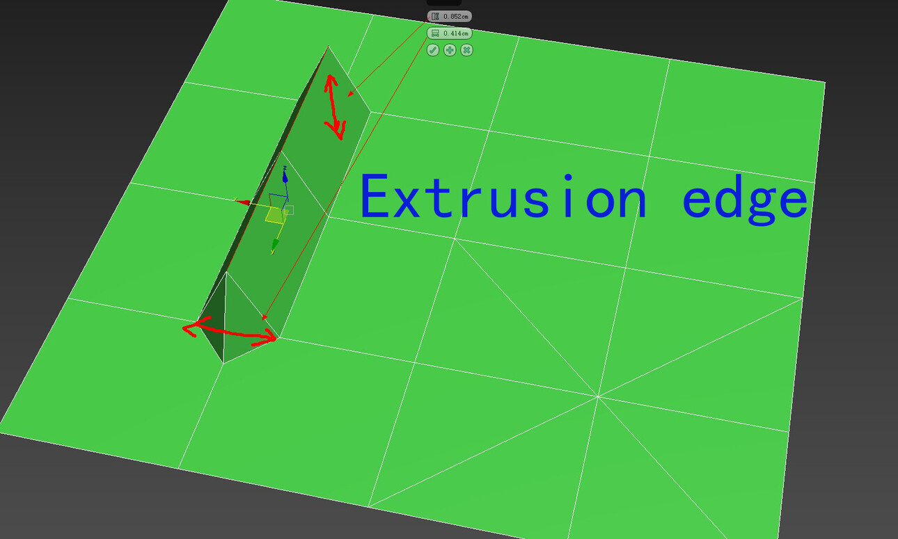

Extrusion edge, vertex, corner cutting, vertex opening function, development request in V8!
Many of these basic modeling functions will be useful in the furniture industry. Some existing subdivision modeling capabilities need more beautiful tool support! thank you!

@BrianJ @theoutside - is this kind of stuff on your radar?
Chamfering a vertex is a request filed as RH-46804 and is on the v8 list for @Jussi_Aaltonen
There will also be a new command in the 7.11 service release candidate called SubDExpandEdges which should help with the second request.
