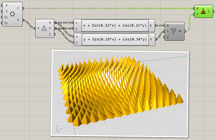

Hello, I am working on a computational modeling project, and am having issues when it comes to pulling cones in different directions to achieve the look that I am supposed to mock. The base surface is completely flat so the only reason you see the wave effect is based on the direction/angle that each individual cone is standing (I would assume based off of attractor points of some sort, which is where I get confused as how to make). any feedback would be appreciated!
You’ll have to decide for yourself how you want to get this done. Equations? The UVs of a surface? Attractor points? Attractor lines? Fields? You have a lot of option but you need to decide how you want to control this before anyone can help you figure out the details.

This response works most closely to what I intended the outcome would be; however, the only concern is that the way the cones are pointing are not in differentiating linear directions. I am just unsure how to do that.

I would like to use attractor lines
You could change the equations for example. Instead of having completely separate equations for x and y, you could instead generate a single strength value for every (x,y) pair, and then multiple that factor with a direction vector. This would guarantee that all your cones are deforming along a single direction only.
And here’s a way to deform a pointcloud using various lines. The distance from each point to all lines is mapped onto a falloff curve and then multiplied by the line tangent vector. This results in n vector forces on each point (one for each line) and these are summed together to yield the final deformation.
