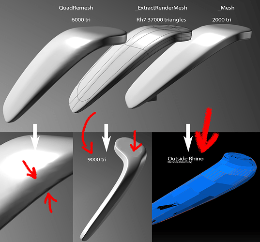

ye here is the problem
Is the same object made using SubD and I tray to export it as a mesh with UV mapping
On the right quad mesh destroy edges
On the center convert to mesh, makes a lot of triangles.(**)
On the right , _Mesh is destroy when exporting.
So the best option is to extract render mesh.
** But Is not possible to _ReduceMesh of a SubD mesh becuse
  • you can’t reduce poly count because you loos vertex normal continuity.
  • you can’t rebuild normal because you loos vertex normal continuity.

But is not working with SubD as shown in the fist image
I include the SubD fileSubD to Mesh.3dm (2.3 MB)
Yes that is working! Thanks
