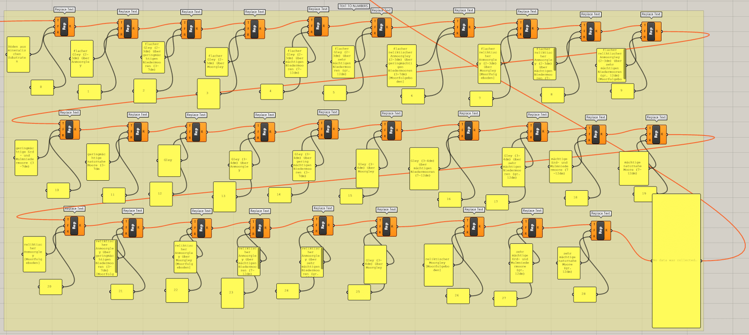

But its not possible to internalize a plugin-component right ? so what can i do. i just internalized the data in later steps. should i delete the comonents, so that there are no objects missing ?
This is what the left side of your model looks like to me. The orange components and wires indicate missing data/geometry.
