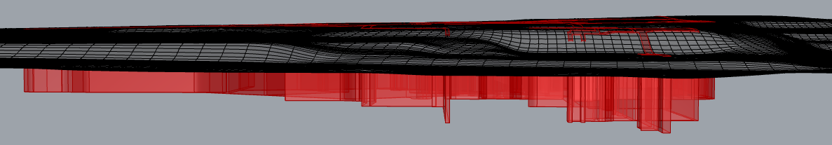

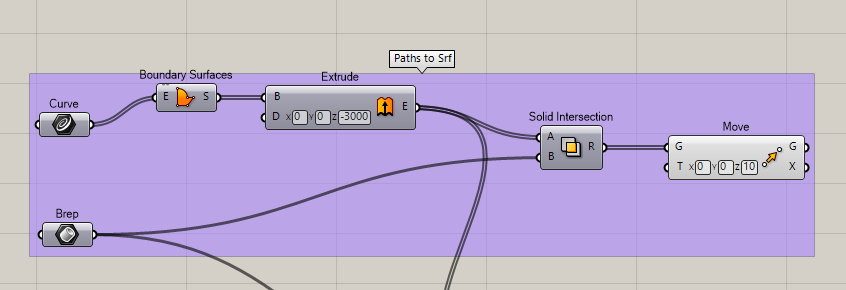

I’m trying to find a component for my use case but can’t seem to. I’m trying to make a script that will deform/project my 2d pathway onto my curved topology brep. I think that trying to extract the split/intersecting surfaces and then extrude it slightly normal for a pathway would be the best way to get the result I’m looking for. I’ve found that with Solid Intersection I can get pretty close to what I want, but then I end up with all this extraneous extrusion underneath, and the path I simply moved vertically, not extruded normal to the surface like a solid Offset Surface would do.

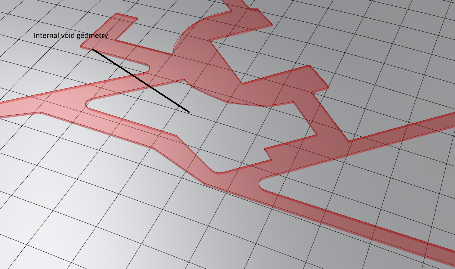

Another concern is that there are internal curves so I need to use the boundary surface to ensure that there isn’t problems with internal volumes being double extruded.
I’ve included a sketch of the idea of the surface region I’m trying to extract, if that helps. And hopefully my grasshopper file has the geometry properly imbedded for you.
