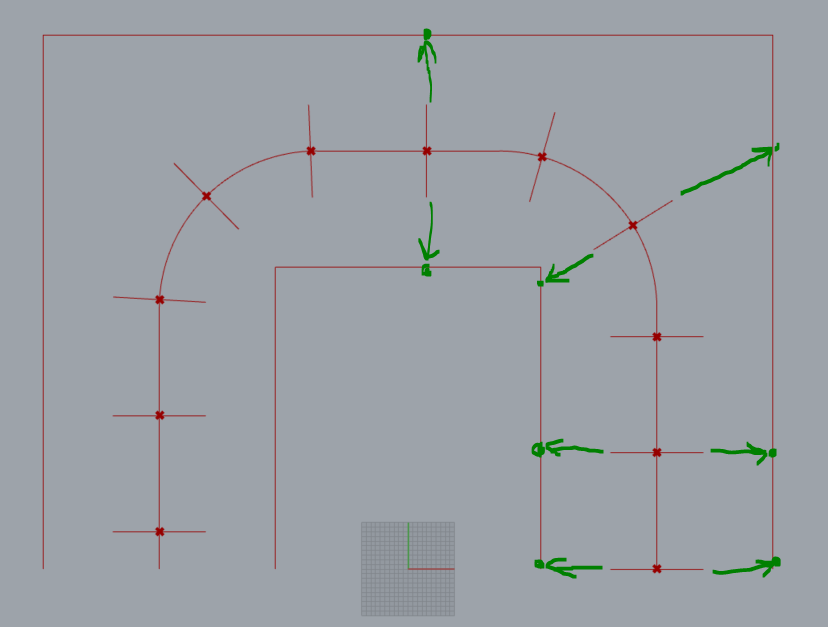

Hello, tried to find a solution here but had no luck, so maybe someone could help me with this script.
What I want to do is to extend vectors, that are normal to points that I got from the curve. And then I need to extent those vectors to both sides of cuves. (green arrow).
Tried to extend it and find intersection points, but it’s no good because if I change dimmensions of curves, it fails, because lenght of vector does not change automatically, and some curves that I need have different lenght.
Also if I extend curves too great, there are points on the other side of curve. Splitting with regions did not work also.
Any ideas?
Laiptų scriptas.gh (21.6 KB)
