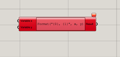

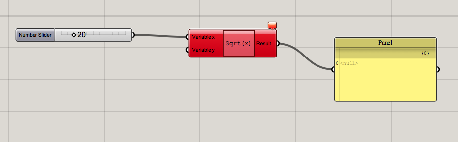

Learning about Expression Editor via some You Tube tutorials and I am having trouble getting it working because it starts all red and whatever I input into it stays that way with errors. Is this a bug in this beta version or am I doing something wrong?16 AM
The expression is looking for variables named “Variable x” and “Variable y” because that is what you have as inputs. Right click on the input and change the names to “x” and “y” if that’s what you’re using in your expression.
Yep, that fixed it!
Thanks for the help!
