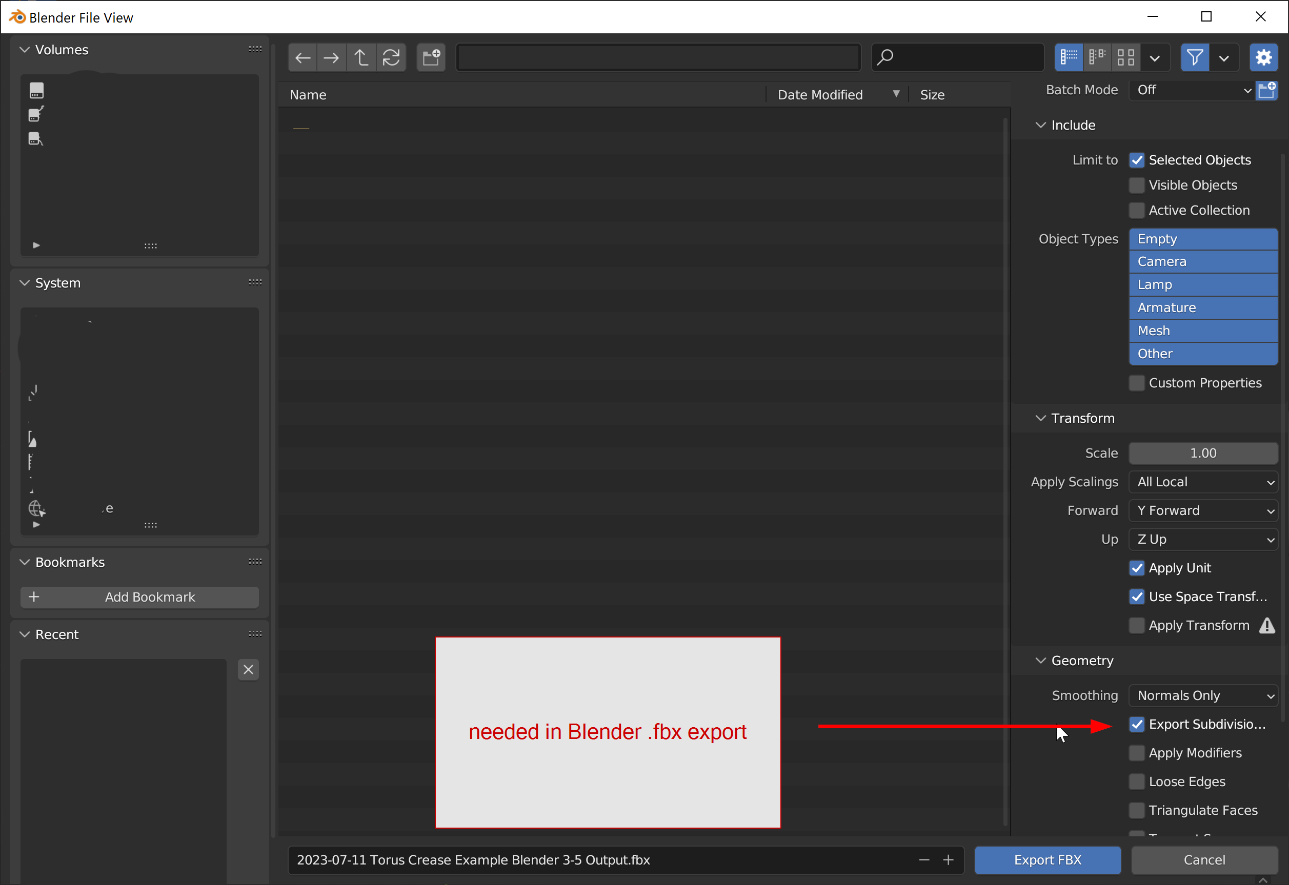

First created a torus object in Blender, added some full creases and push and pulled some verts. Exported from Blender 3.5 with the following settings.
2023-07-11 Torus Crease Example Blender 3-5 Output.fbx (15.7 KB)

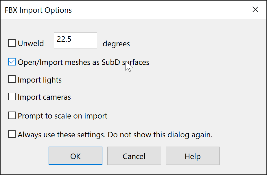

Imported into Rhino with the following settings:

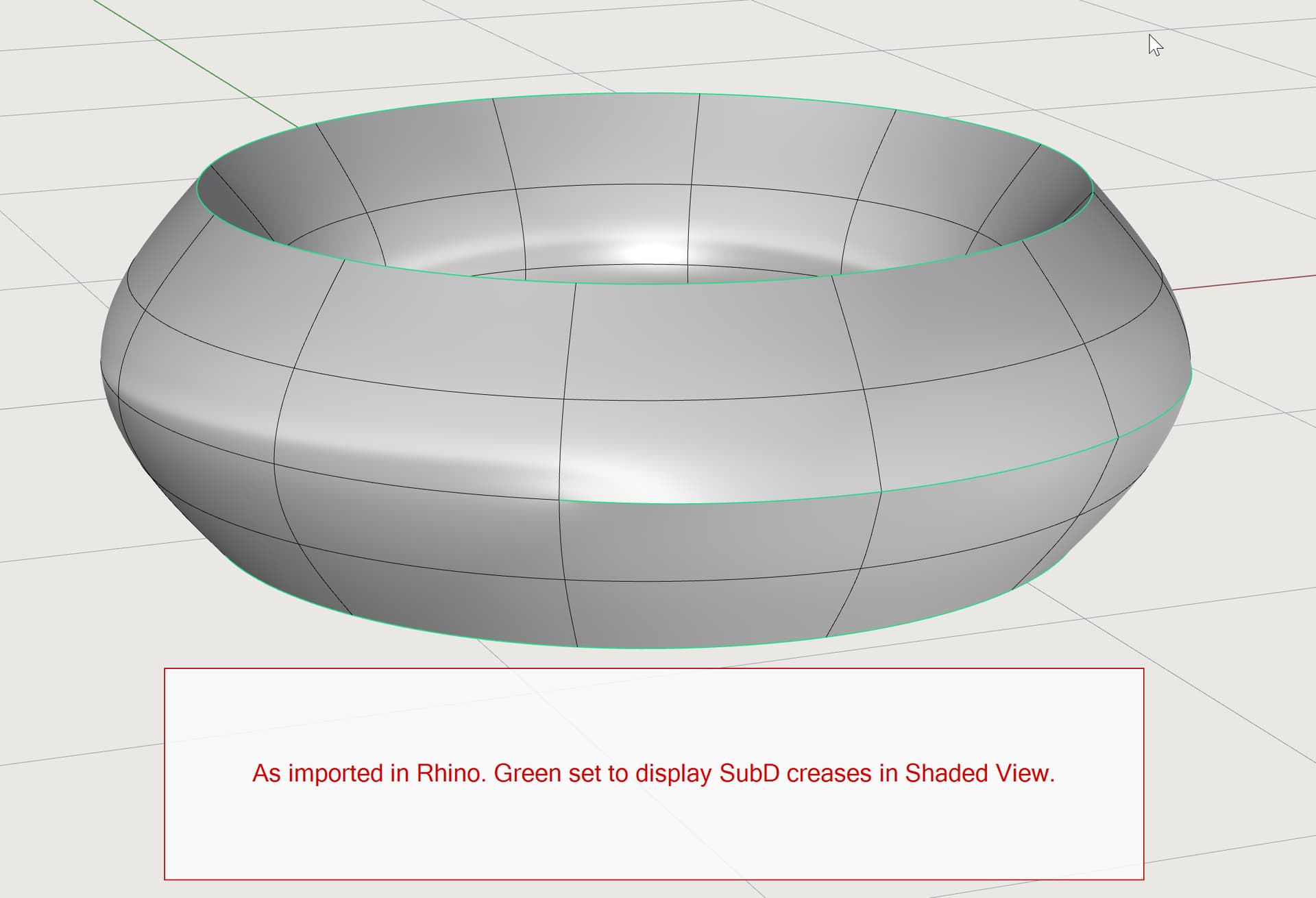

This is what it looks like in Rhino right after import. The edges I had creased in Blender are coming in creased.
