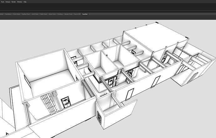

Do you have a workflow for doing back and forth trips between rhino and blender?
For example, Im developing a building in rhino as I can control the dimensions, do plan/section/detail layouts with notes/dimensions, but I want to texture/render it in Blender. So I use your plugin to import the model and do my texturing in blender. However, at some point, some of the dimensions might change in the model in rhino, or new elements added.
Any suggestions for how best to update the blender version of the textured/lit model to reflect the changes/additions in rhino version of the model?

I do not have a workflow to go back and forth. I know this is something people have been wanting for quite a while, but there is nothing that would help with that currently. If you were to work with meshes only then you could export from Blender as OBJ and import that into your Rhino. But there is not a good way currently to maintain say a polysurface as a polysurface in a roundtrip way.
I personally only really go from Rhino to Blender for rendering and animation - modelling I can do in Rhino.

Money does the trick. 🙂 Maybe we can get a crowd fund going? Could grow into a nice amount.
btw Im importing a rhino model with the plugin and it’s showing up as curves. Any ideas why or how to resolve so comes in as solids? All layers are on in blender.
 ![image](https://global.discourse-cdn.com/mcneel/uploads/default/original/4X/b/4/e/b4e08f65a7cc4ee641ba352bef2a6dfac5f864e7.jpeg)
 ![image](https://global.discourse-cdn.com/mcneel/uploads/default/original/4X/f/6/7/f67a83bf6776b2f7dd2348e9254a8b56d5f476b8.jpeg)
