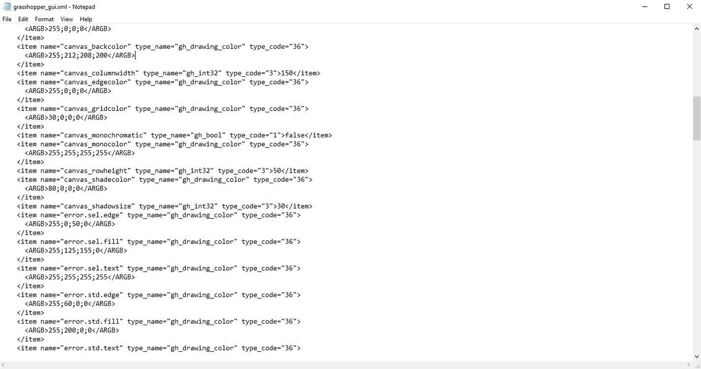

yes, I know but I don’t know the default ones.
If the grasshopper_gui.xml file is removed, it returns to the original setting when restarting GH.
Before changing a color, keep the original color (just get instead of set) in a global variable and use a button to use that default or user color.
Default colors:
grasshopper_gui.xml (11.0 KB)

When I deleted that xml the default colors returned but not the xml file
Go to File -> Special Folders menu. in Settings Folder open grasshopper_gui.xml in something like notepad. You will see all the values there.
Update: the picture above is after deleting the xml, with rhino closed. Then restarted rhino and grasshopper, the file was still missing. It appeared after the second or third restart.
Yeap just saying if you are feeling particularly lazy and don’t want to close and reopen. :smiley:
Maybe a stupid question, but you closed and reopened? Worst case steal it from @Dani_Abalde he attached it in his above comment.
Restart RH and GH again.
