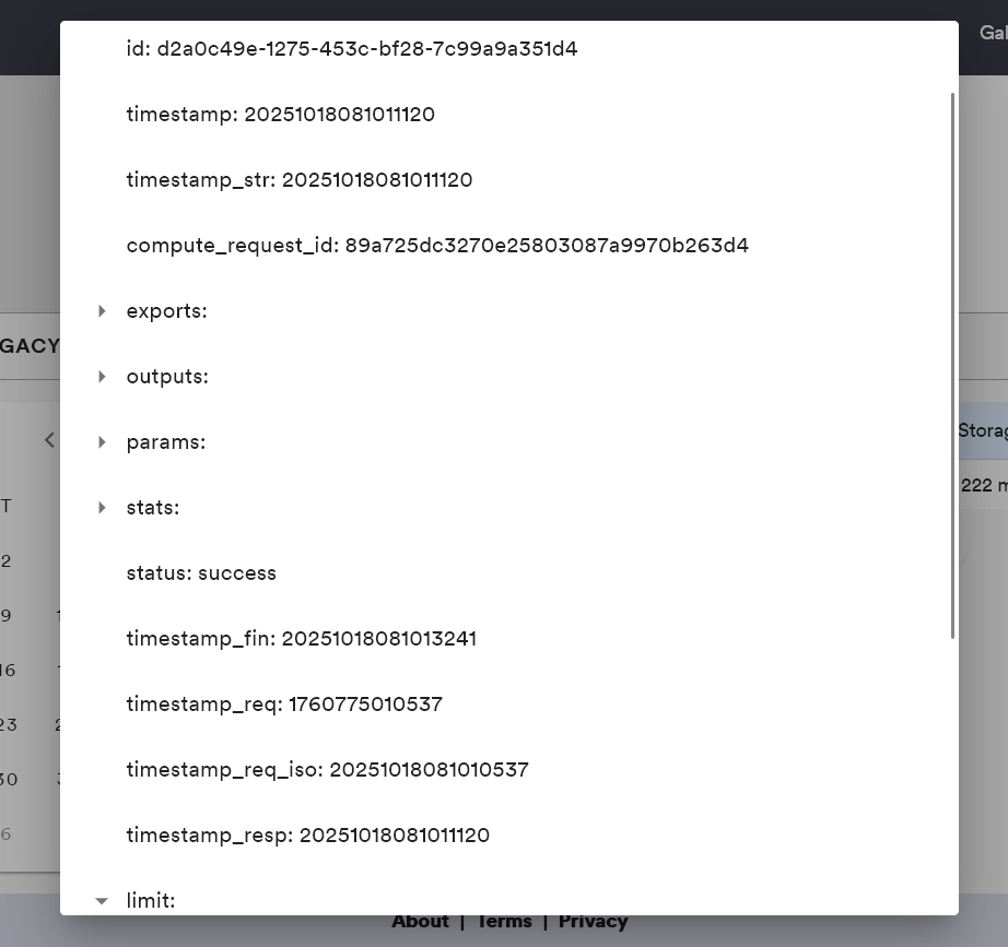

Ok It worked after clearing the cache, I tried exporting but still returns a Blank PDF.
The status states it’s a “success” and computed quickly but the PDF is empty, same export option through grasshopper exports properly, the problem only exists in the app.
