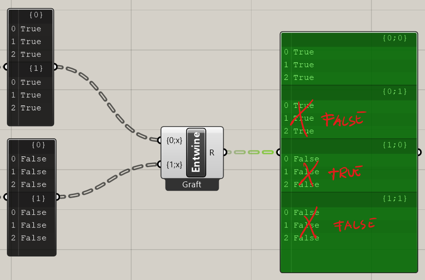

How can I entwine the branches and still keep the data structure as shown? Is the only way to do this through python?
I tried with the path mapper, but no luck.
\*Edited with better picture
 ![image](https://global.discourse-cdn.com/mcneel/uploads/default/original/3X/d/b/dbde4492a0131f294654ddc480da1e909335191a.png)

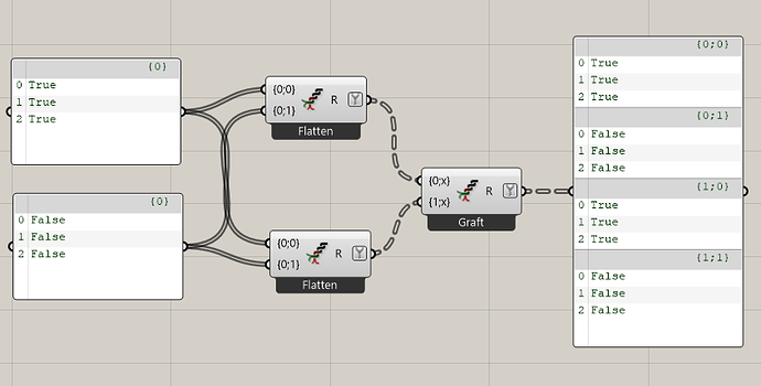

i don’t understand what you are asking.
 ![image](https://global.discourse-cdn.com/mcneel/uploads/default/original/3X/0/f/0f7b60ef1b667c2a311c44b09e1c114089339f61.png)
how the data is gathered seems relevant

here is a tree branching method
 ![image](https://global.discourse-cdn.com/mcneel/uploads/default/original/3X/f/b/fb6c4ed917c3711bcd620e80b66310d8d407f3f5.png)

Thank you for the replies.
So while having only two branches in each input the problem can be easily solved, but what I have is a situation where there might be more or less branches in each list. If that makes sense. I basically want to do what you are showing in your picture, but where the number of input lists can vary.

I just realized that your second one will work perfectly for what I am doing. Thank you. 🙂
