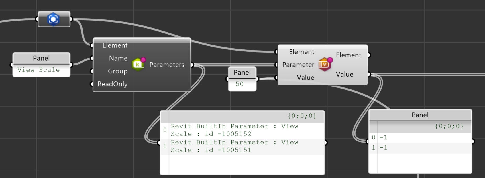

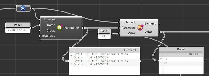

I’m changing the view scale of a view with Rhino.Inside in Grasshopper using the “Element Parameter” component, but after I plug in a number in the input “Value” the output “Value” returns -1.
“Element Parameter” correctly displays the scale of the view before any change is applied, the glitch only happens once a value is set. The value correctly changes in Revit so no problem on that side.

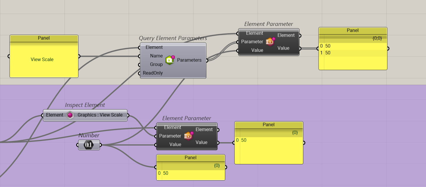

Hi @Alan_Eskildsen1
Which RIR version you are using?
I don’t see that issue here.
These are the versions I’m using:
Rhino.Inside Revit: 1.31.9214.19602 (2025-03-24T10:53:24)
Rhino: 8.20.25157.13001 (Rhino 8)
Revit: 2025.4.20 (25.4.20.11)
