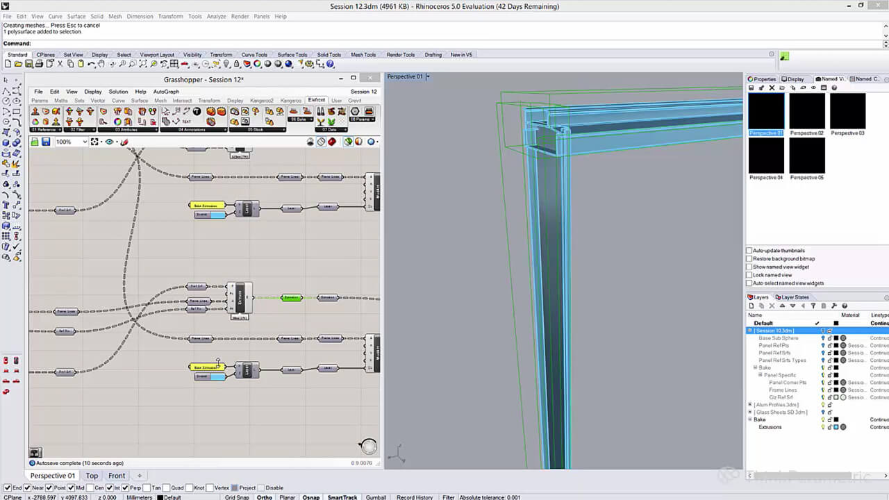

#14
Here you have :slight_smile:
(Rickson) #15
That’s a fantastic resource, i had to figure it all out on my own. I’m going to recommend it as our in-house training.
#16
Thank you for pointing to this course. Very useful.
