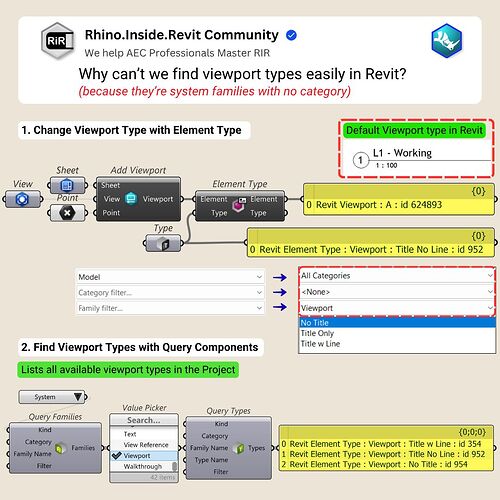

I am hoping to leverage Rhino Inside to bulk generate sheets, views, schedules, etc. in Revit. Is there a way to edit the view title of a viewport using Rhino.Inside? As an example, I have a legend that does not need a view title on a set of Revit sheets. Am I missing something? I tried to find this parameter using “Inspect Element” but none seem to correlate to this parameter. “View Type” was my guess but this seems to be a separate parameter than the one I am hoping to edit
@Basualdo_Armando please check the following workflow
