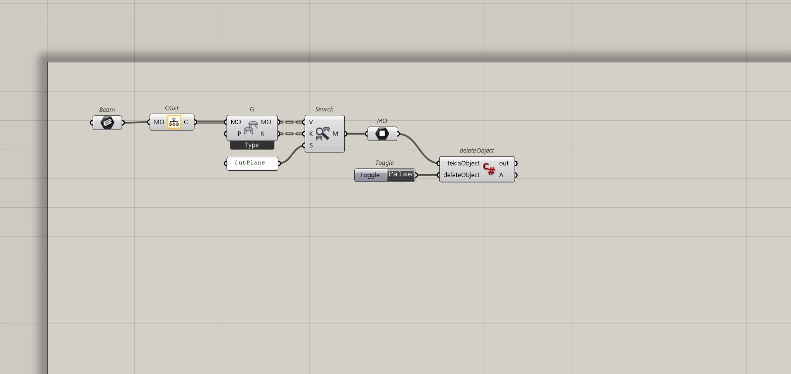

@sebastian.lindholm not only beams i want to delete some thing like cut part plane cut for a part similar items too could you make a delete button so we can select the part which we dont need and use it with a toggle function
here is what i did with chatgpt to fix my issue
deleteObject.gh (6.4 KB)
