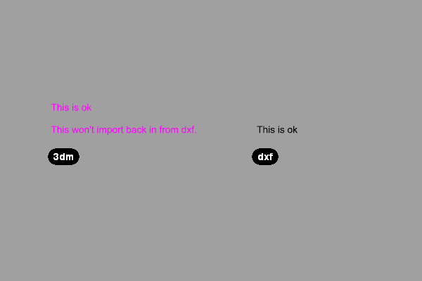

I posted a while ago about DXF export problems on the Rhino5 Newsgroup (Here). It seems the problem still exists (Rhino Version 5 (5.1.30129.1756, 29.01.2013)), so I wanted to pop it up again. I hope it can be fixed soon. We cannot use Rhino5 in production at the moment due to this error and I think many others will also run into this problem (maybe even without noticing).

Hi Silvan- if I import the dxf back on top of the 3dm file, I get exactly the same thing on screen, though I see in Properties the text is arranged differently- is that what you are pointing out?

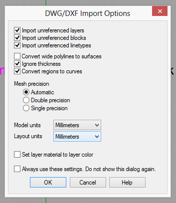

Unfortunately it does not work for me. I am using the default export scheme for dxf, and the following settings for import:

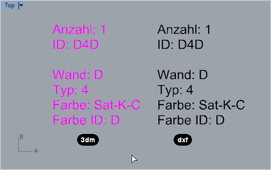

I am still getting the following result:
I am using Rhino5, 64bit on Windows 8. The file I tested with is a fresh Rhino file with only the text in it. I will send the files via email.
Silvan
Please update to Rhino V5 SR4 and try it again.
You’re using an old SR1.
